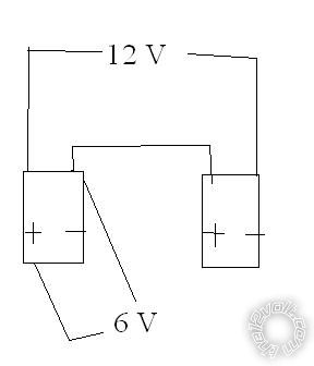

Hello I have a old moped that we have modded, and added custom headlight and turn signals, as well as a new stop and running light.   Mostly LEDs.
The first problem I had is the bike has 6v charging, and lighting.  I have been unable to find a replcement coil/stator that will supply the 12v.   I was told that if I just hooked up a 12v batt the charging coil would over heat and die.
So I came up with a rather weird way around it.    I have a few relays that the 6v. output from bike, (after the rectifier, So its 6v DC)  will "trigger".  This will allow 12v dc from a 12v batt. source, to flow through the relay to now power my 12v accesories.  Less than 5A draw is planned, so the relay should take it.
I know seem like lots of extra work, but...
So next thing I need to know is can I run the original charging output (6v DC) to a 6v sealed, battery?  Then wire a 2nd in series, to get a 12 volt out?
Can I tap off/on  the middle.  To at least charge one battery, more so the power has a place to go and not blow a regulator or coil.
I think I need to use diodes or something to Isolate the point, that the bike is hooked up to one of the batterys.
Can I put the charge to the first battery, then feed through a diode into next battery?  Will this make the bike "think" its attatched to 6v and not damage the bike?   Because the lighting draw will be low will this put "SOME" charge into both batteries?
I'm not sure I am explaining it well enough.
let me know if I am WAY off on this one.
safe dual battery w/ half power tap -- posted image.

So I did the real world test>>>   I have (2) 6v 5Ah batteries.  hooked in series.  and just like the pic up there. I does show 12v across both,  BUT 6v on each battery seperately.  My concern is that there will be feedback of 12v back into the charging system."
So could I use some diodes in between the charging coil and the battery?  What size?  is it based on the power going TO the battery,  or the power That gets drawn from the battery?
I'm not to worried about charging both at once. I will charge as a Total loss system if need be.  But I don't know what to expect  yet.   with @ batteries in series.  how will the batteries discharge?  Evenly or on more or faster than the other.
I'm not sure about what will happen to the "charge" if only charge one at the time.  In parralel one battery would supply power to the other right?  What ever battery is lower the power would find it?
Also in series I know I double the voltage, but what about Amps? is it now just 12v  @ (5Ah)?  More or less?

You can't wire it so that you can charge both batteries.
And if you only charge one battery, both will fail before they should (unequal current charge/draw in series batteries - akin to "don't mix batteries" in any series-battery connected device - eg, remote controls etc.)
The options you have are:
- a 6V to 12V converter;
- depending on the stator winding, it may be possible to reconnect for 12V output. IE - if 2 coils with a GND centre tap, break the GND and GND one of the ends. That's 2x voltage output, but at half the current.
(Forget transformers - the varying output frequency makes dc-dc converters more compact & efficient. And I don't think voltage-doublers would be suited, though that depends on the Amperage required.)
As to 6V windings charging 12V, they should not fry. The insulation is likely to handle 12V, and 6V systems use twice the current of 12V systems for the same power/Wattage loads.
However other components might - eg, it may be a charge dumping system using a ~6V zenor (probably 7.5V ).
Is the alternator controlled - ie, by a voltage-regulator driven rotor?
Chances are however that it's a "stator" system - eg, a permanent magnet rotor whose output voltage is determined by the number of stator windings and RPM. They either dump excess voltage (hence current) or only pass thru the output when needed.

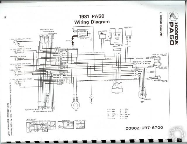

As if this isn't already long enough - now I'm inserting that diagram...

The wiring diagram is the best match to my original system.
