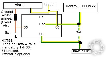

Posted: April 05, 2012 at 3:39 AM / IP Logged
Or even safer from a reliability point of view look at the inertia cut off switch, physically likely to be in or near a kick panel, the wire going to it from the control module, DG/YE (dark GREEN/ YELLOW?)use this diagram:-
Note I've given you the option of EITHER alarm control OR a switch.
In my opinion anything that can block a moving vehicle is COMPLETELY unsafe and isn't recommended by the authorities either in the US or UK though the Australians say do it.
Be it on your head.
vinsanity0429
Member - Posts: 15
Joined: March 11, 2012
Posted: April 05, 2012 at 6:17 AM / IP Logged
That is exactly what I needed! Thank you so much for the help.
