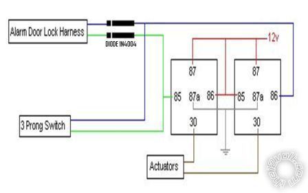

hi all,
does anyone have a wiring diagram for the spal 37000118?
I'm adding this switch to aftermarket actuators.
additional info:
Truck-99 Tacoma
Alarm-Python 533
I'm using a relay pack DEI 451m.
Thanks in advance.
spal 37000118 door lock switch -- posted image.

Edit for my previous post:
here is the link for the switch that I want to install.
http://www.spalusa.com/store/main.aspx?p=itemdetail&item=37000118
thanks.

Posted: May 08, 2012 at 11:48 AM / IP Logged
one more question howie ll,
is necessary to add installing an after marker door lock switch?
Thanks in advance.

Edit my above post:
question was, if is necessary to add Diodes when adding a door lock switch.
sgarcia1212
Posted: May 08, 2012 at 8:33 PM / IP Logged
No it won't work you need a 5 wire actuator and a dedicated timer relay from Spal, Mes etc. And all the wiring will be different.
