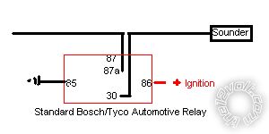

Ok. think I figured it out with some research on my own but maybe someone can confirm...
85 to gnd
86 to switched 12v
87A to door lock motor wire on vehicle
87 (not connected)
30 to the positive side of siren wire
ground the negative side of siren to chassis
Posted: June 04, 2012 at 4:23 PM / IP Logged
No no no no.
85 to ground.
86 to lock motor wire (It's in the body control module).
87 to 5amp constant 12v+.
30 to siren pos.
87a not used.
The other diagram I showed you is for ignition interrupt.
Posted: June 04, 2012 at 4:26 PM / IP Logged
By the way, if you used a switched (ignition, ACC) supply the siren would ONLY sound with the ignition on,and then by connecting 87a all the time the ignition was on.
Could I suggest you follow Tommy's good advice?
You don't really seem up for this.
