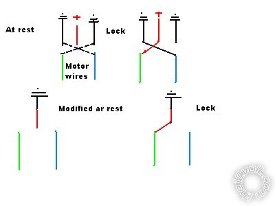

All you needed to do assuming that switch was a momentary 2 pole changeover was to convert it to grounding. Remember on those switches the grounds at rest are always connected to the outputs, hence ground the POWER input which isn't connectred.
If you apply a ground to the INPUT side of the 451, the thin green and blue, one at a time you will lock and unlock the vehicle that's what reconfiguring the switch emulates.
This is so basic how did you ever get to be a lead installer.
The following diagram shows you original configuration and an example then modified and an example:- 5C1_switch.bmp

You just don't understand, did you read the diagrams I posted? Of course the outputs are grounded at rest this is equivalent to type one electric windows as on a 530t.
Don't connect the grounds, connect 1 x ground to the power input and the the "outputs" go back to the thin input wires of the 451.
How much simpler can this be?
I'm not questioning your work ethic, I'm questioning your basic lack of electrical knowledge and why you can't make such a simple thing work.
All the switch is doing is sitting parallel to the 451 inputs and emulating the alarm.
Which is effectively the same as controlling type "A" central locking.

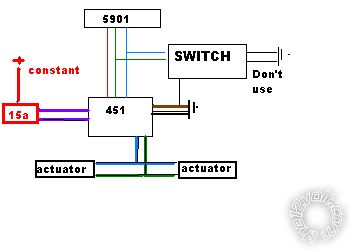

Posted: June 11, 2012 at 5:00 AM / IP Logged
Here is a layout, perhaps this might help:-
