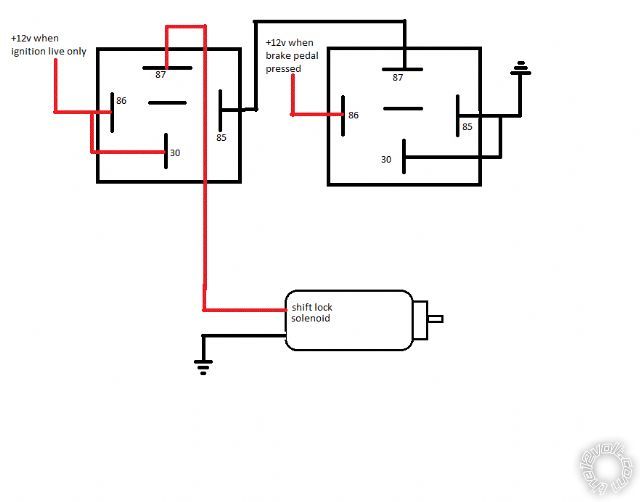

bummer, i was hoping it would have been an electro solenoid type device like on my brothers f350 i seem to spend so much time installing things in.
 and i just drew a pretty diagram in paint lol shift lock, 2010 jeep wrangler -- posted image.
well if it was an electronic shiftlock this would have been somwhat of an idea,
first relay on left will only work when ignition is on and brake pedal is pushed to complete the energizing of the coil to supply 12v to solenoid to release shiftlock and would have also allowed the transmission to stay locked in park when you had the vehicle parked and armed,
do'h thought it would have been a solenoid seeing as its a 2010 and the f350 ive been working on is only a 2006.
hopefully you can have a moment of inspiration from this and find a solution.

well that could work if i get a solenoid though wouldnt my setup need to perate the solenoid in 2 directions, one to lock it and one to unlock it?

Posted: June 12, 2012 at 3:19 PM / IP Logged
you should be able to find a solenoid with a plunger that springs back out when power is removed from it so would only need to energize it to retract it.
doing funky things with relays isnt one of my strong points as i dont use them enough but you should be able to have a circuit that would operate in both directions, no doubt there are some other users on here that are wizards when it comes to doing things like that with relays and may be able to offer more ideas than my limited scope.

Thanks tony I've played with alot of relays just not for this application, I actually wasn't aware that I could get 1 that would spring back but that makes perfect sense and ur diagram would work in that case. I guess it's off to the auto parts store, thanks again.
