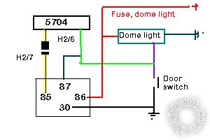

Last thing, my dome light supervision wire wasn't hooked up. This is the wire that makes my dome light flash once the alarm is triggered, correct? I would like to hook it up, just checking to see if i needed relays or something else not straight forward. Or do i just connect it to the factory harness dome light negative (-) wire (no relays, funny business, etc)

Again, NO!!! it simply holds your dome light on for about 1 minute or until the doors are shut and you turn on the ignition.
If the vehicle already has a dome light delay then it isn't needed.
If it hasn't then this:-

Posted: July 20, 2012 at 1:47 PM / IP Logged
Ok, I will follow the diagram.
---another amateur question. Sorry....
I didn't see 87a in the diagram, is the relay in your diagram a 5pin (changeable relay) or a the switching 4pin?

Posted: July 20, 2012 at 2:17 PM / IP Logged
Wiseman118
Posted: July 20, 2012 at 4:28 PM / IP Logged
It doesn't matter, if you use a 5 pin just don't use 87a.
On a 4 pin 30 to 87 are the switch on a 5 pin 87a and 30 change over when activated but for simplicity (I buy 20+ at a time) I use 5 pin relays and they fulfil either function.
