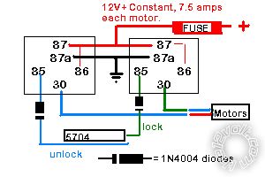

Does the 514L come as a kit with it's own relay?
If not the default wiring is NEG (-) lock and unlock, green and blue, going to relays wired as "add actuators" see the relay section on this site.

Posted: July 09, 2012 at 5:10 PM / IP Logged
Like this,fused at 15amps for 2 motors, 30 for 4 motors.
You will need those diodes:- add_actuators.bmp

What would happen if they werent installed (the diodes)?
Where would i pick them up at?
Posted: July 10, 2012 at 2:34 AM / IP Logged
Good chance that you will fry the 5704.
