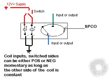

Posted: July 24, 2012 at 11:00 AM / IP Logged
And here's one of my diagrams showing the switch.
This one's an SPCO:-
