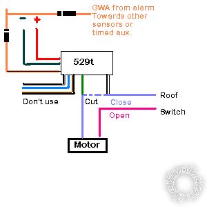

i got a 02 nissan sentra spec v. im trying to install the 529t to operate my sunroof. only issue im having is that it just pulse little by little when i try to activate it with the remote to open with my 3303 remote. also when i arm the system it also pulse to close..ive been trying to figureout how to get a full negative signal instead of small pulse but i dont know how, been going at this for a few days now....hopefully i can solve this issue.

To close are you using the same output (GWA) you used with the 530t but diode separated?
To open it will only move for as long as you hold the button and then it will take 1.5 seconds before responding.

yes im using the same ground to arm as i did with my 530t....all i did was spice it in with my orange 530t wire harness...
i did hold the aux button, all i get is a pulse and a crack of the sunroof......
i still have the gray and gray/black wire i didnt use....im so lost

Have you gone to the motor wires?

i can only go to the motor becuz the sunroof switch only work with ignition on.....
im assuming i need the dei 528t pulse generator...... or mayb buy another 530t instead of using the 529t.
im completely lost
Specvay
Posted: July 16, 2012 at 5:59 PM / IP Logged
The switch isn't relevant, you're getting power through the 529t red wire.
