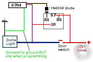

Correct but disconnect the green, use the violet (+) door trigger instead you can still connect yellow black but like this:- C8A_ford.bmp
You will need a relay 4 or 5 pin and a 1N4004 diode for the dome light.
Connect the original green to ground only whilst you program the unit.

Smokeman on the British versions if you're using the violet (+) POS trigger you must ground the green during programming otherwise it won't respond.
OP had the green connected when the dome light is POS switched and then the neg output BLACK / YELLOW supervision wire sans relay also connected.
A real case of RTFM or even RTF bylines or signatures of you and I.viper 5704 remote start issue - Page 2 -- posted image.
The part that says READ the instruction manual.
Posted: July 23, 2012 at 3:20 PM / IP Logged
OP, RED RED / WHITE and RED / BLACK should ALL be connected to a constant power supply, again, RTFM!
I'd be surprised if you haven't fried the circuit supplying the BLACK / YELLOW dome supervision wire.

I agree with Howie, looking at your list of wires connected your Red, RED / White, and RED / Black should be on a constant 12 volt source as well as the Red on the  main harness.  Bulldog list this wire as Yellow(+) or Light GREEN/ Purple(+).
Have you tested these wires with a Digital Multi Meter?
In the downloads section is the install manual for the Viper 5701 which has a section in it on testing the wires you are looking for.
