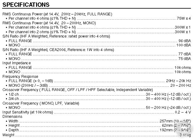

The fifth channel of the PDX is rated into 2-ohms, but the front four are not.  Now it may handle that load especially if it's not being pushed too hard, but these ICE-based class D amps are notorious for not liking being overloaded.  That's not likely to be causing your problem, of course.  If it was distortion from overload it would occur no matter what was happening with the vehicle.  Most likely you have a bad speaker wire connection or a blown speaker.

well, DYohn is right, copied straight from alpine website:
Features and Specification
SPECIFICATIONS
CEA-2006 Power Ratings
CEA-2006 Power Rating: (4 I? @14.4V Ƈ% THD+N, S/N: 77dBA, ref:1W into 4 I? and 2I? for mono ch.) 75W x 4 + 300W x 1
RMS Power Ratings
Per channel into 4 Ohms: (@ 14.4V Ƈ%THD+N, 20Hz - 20kHz @ 4I? for 4ch.) 75W x 4
Per channel into 2 Ohms: (@ 14.4V Ƈ%THD+N, 20Hz - 200Hz @ 2I? for Mono ch.) 300W x 1
its for the marine version of the PDX-5 but they are the same amp. the specs are a little hard to understand though. it must only be the five channel though because my PDX-F4 is rated for a 2 ohm load per channel. not sure where you bought the amp from but a lot of websites have a tendency to mislabel product specs
Platinum - Posts: 13,726
Posted: July 25, 2012 at 12:18 PM / IP Logged
All of the PDX amplifiers are stable into a 2 ohm per channel load. They do not give the 2 ohm rating because they specifically state that the amps produce the same power into a 4 ohm or 2 ohm per channel load.

The PDX-5 will run 2-ohms on the sub channel only. Please see the spec sheet, excerpted here:
mix speakers? -- posted image.
Nowhere does it mention 2-ohm operation on channels 1-4.
That's besides the point... Check your RCA's first. Drive around with an iPod connected to the inputs, and see if it goes away. If so - deck or signal wires. If not, speakers or OEM wiring.
