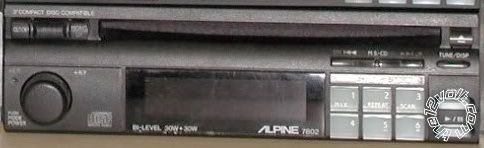

Howdy, to all you expert Audiophiles,
I recently bought a used car with an Alpine 7802 old school HU, and no matter what I try, I can't get the clock to start flashing, so I can set it.
I have searched the internet for the manual or some literature about this radio and the only info I can find is from guys in forums like this, so that's why I'm asking for help with this here.
I private messaged someone here also, so hopefully either he or you guys can help me.
The writing is pretty worn off of the controls and through pictures that I've found on the internet,   (one that's below),   I've pretty much been able to figure out how everything works, and for how old it is, it seems to be pretty good quality.    But even though I can get the clock to display, either while the tuner is playing or not, I can't find the right key to hold to make it flash, so it can be set.   Then, even if I do find the right key to get it to set, then which keys do I use to set the min. and hours?
Any help in this, I'm sure, is a simple matter, will be appreciated. I feel so dumb, not being able to figure this out myself. Even though, an owner's manual would be nice to have with this unit.

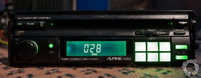

P.S.   I found some other units that are pretty close to this unit, but I can't find any info or manuals on them either.   (pics below)
alpine 7802 unable to set clock -- posted image. alpine 7802 unable to set clock -- posted image.alpine 7802 unable to set clock -- posted image.alpine 7802 unable to set clock -- posted image. alpine 7802 unable to set clock -- posted image.

Posted: September 03, 2012 at 12:06 PM / IP Logged
Thanks to all who posted solutions.
I finally figured it out. I knew it was something really simple.
While holding the clock button in steadily, press and release the 5 key(hr) until coming to hour desired. Press and release the 6 key(min) until coming to minutes desired.
If it weren't for the pictures above, showing which button is which, I never would have figured it out.
