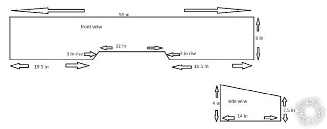

Posted: September 06, 2012 at 2:45 PM / IP Logged
well here a little rough copy of a full downfire with my trucks dimensions.sub box build -- posted image.
Hope this helps
DYohn
Platinum - Posts: 10,741
Joined: April 22, 2003
Posted: September 06, 2012 at 3:12 PM / IP Logged
OK, so that's about a 2.6 cuft enclosure, or about 73.6 liters.  Deduct about 10% for the volume of the woofers and the necessary braces, and you end up with a relatively small 67 liter enclosure.  Put both drivers in it, port it for tuning at 21.7Hz (2" diameter port that is 5" long) and you'll end up with a peaky system but it's the best you can do with those woofers.  You'll also have port noise but I don't think that will matter.  Also, with 800 watts being thrown at the woofers you will bottom them out around 80Hz, so be careful with the volume control and if you hear them making mechanical noises, turn it down.
