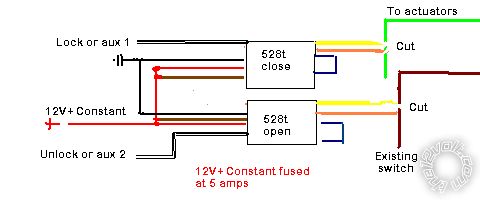

Posted: September 17, 2012 at 5:12 PM / IP Logged
This method is fully automatic and doesn't even need the control button:- F3D_mirror_fold.bmp

Posted: September 17, 2012 at 5:25 PM / IP Logged
So I could use that method to make them unfold and fold with the ignition? How would I be able to achieve that with a button aswell? Thanks for the advice really helpful
Posted: September 17, 2012 at 5:47 PM / IP Logged

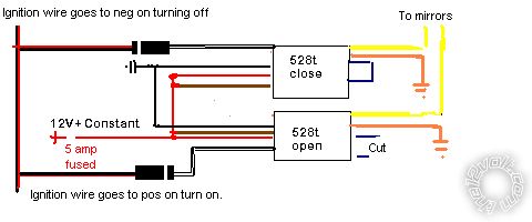

Ign, use that diagram and cut the loop on the "opening" 528t.
wire other trigger wire also to ignition as you turn off the key the mirrors will fold.
Use 2 x 1N4004 diodes.
I've made no provision for the fold button, you won't need it see revised diagram as ignition controlled:- 46B_mirror_fold.bmp
Use 2nd. ignition as trigger feed or ACC, i.e. no voltage on cranking (turn key to start).
