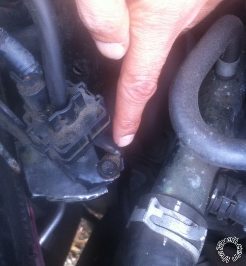

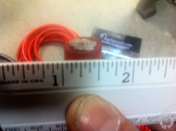

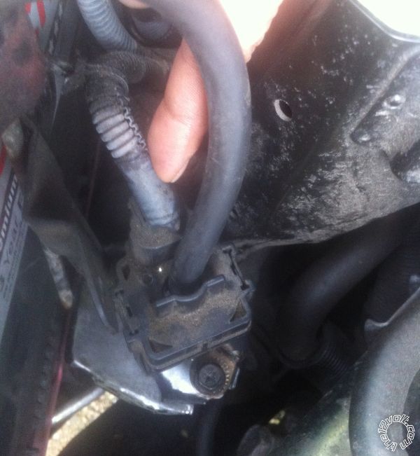

I replaced the factor ground with Knukonceptz Kolossus 4-awg. It was the best wire for the money that would fit in the thought the ground sensor. The sensor opening is 13mm so what ever wire you get it cant be larger then that.
Removing the ground and sensor:
1) start by removing the ground on the battery and then the positive terminals, Put a duct tape over the positive terminal (i like to play it safe). remove the battery for better open work space.
2) remove the connector on top of the ground sensor( I used needle nose to press the clip).
ohio gen alternator for 2007 pathfinder - Page 2 -- posted image.
Then the sensor from the metal bracket(slide it straight up... may need a little force).
3) remove the 10mm bolt connecting the middle ring terminal of the ground wire to the bracket. Last remove the bolt from the engine side of the wire.

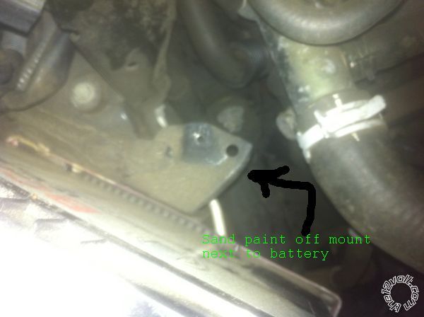

Remove the Paint and clean surfaces:

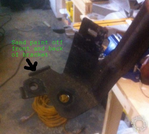

1) remove the 10mm bolt in the middle connecting the bracket.
2) sand the front and back of the bracket and the bottom plate of the area where the bracket sits on. Also sand and clean where the wire connects to the engine( i used a wire brush)

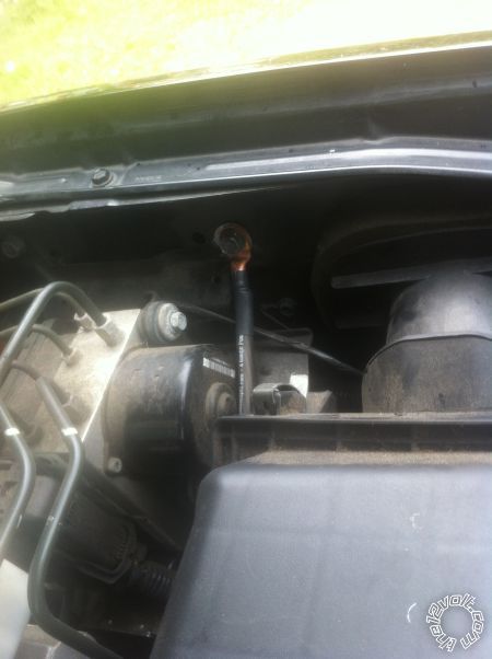

Upgraded the cheap 12awg ground from the engine block to the frame on the drivers side with 4awg. Next will be to upgrade with a 0awg to the Engine ground where the battery is also grounded to the main frame. Also will add a 0awg at the rear where the amp rack will be for the JL Audio 1-500/1 and 2-300/4 amps to the main frame on the driver-side.
Then comes the biggie, Ohio Gen Alt install :)

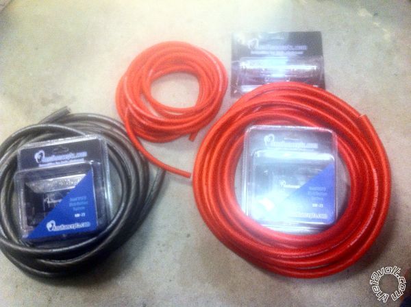

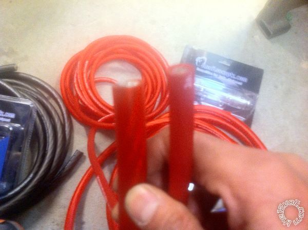

OK just received all the power and ground wires for the Alternator and amps. I love KnuKnoceptz wires. All ready at $600 just for the power, ground and RCA cables. As soon as it warms up in here i can do my Alt and power wire install.....
1/0 main power kolossus
1/0 and 4awg kolossus
