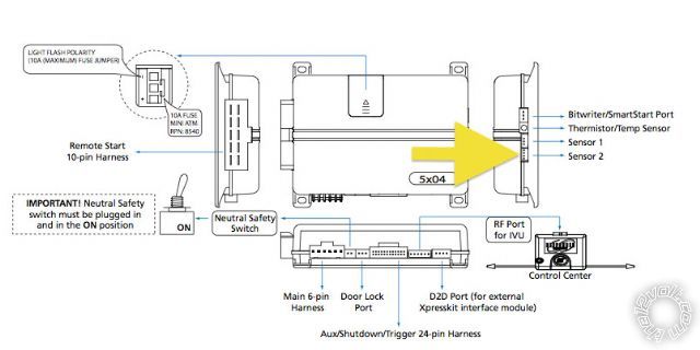

Posted: April 14, 2014 at 4:55 PM / IP Logged
howie ll wrote:
You still plug into the right hand of the two ports but you need a Bitwriter to make it say "Field Effect Sensor".
viper 5904 and dei 508d -- posted image.
Howie,
Here's the plug location. At least I'm pretty sure it's a 4 wire. Anyhow I changed the icon
to Proximity on zone 4 with the Bitwriter and viola.
I just wondering if this microwave is on all the time, judging by the post I've read, it is.
I just don't want to loose any more brain cells than necessary. I would like your opinion on it though.
btw - thanks for info

Posted: April 14, 2014 at 4:59 PM / IP Logged
Been plugging both into those two mux sockets for over a year now 3 plus a week no problems.
If it worries you, join the black ground lead to your orange armed output, then they will only power up when armed. Note no more than one sensor though (508d).
Test before boxing up.
