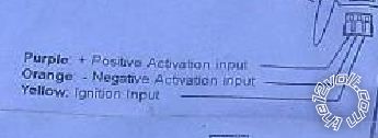

would i also need the ignition wire in the photo?window roll up module -- posted image.
Posted: October 10, 2012 at 12:09 AM / IP Logged
Yes, GWA not GWR.

The good news is i now know what the GWA wire is(orange starter interrupt wire)
The bad news is i can't get all the windows at the main switch because i have window modules in each door. I have to run two wires to each up wires.
