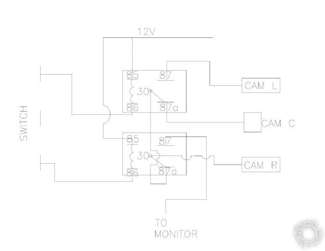

wiring diagram, switch cameras -- posted image.
Thanks Short!
I sketched out the wiring that you described and Im not clear how its going to work.
If the output to the monitor is going to be on 87 (NO) on the second relay, how is the signal gonna get there from the center cam when the switch is on the center position?

Posted: October 10, 2012 at 4:24 PM / IP Logged
Oh my goodness! I apologize. I was typing so fast and accidentally inverted Pins 30 and 87 for relay 2.
So it would be Relay 2 as follows:
Relay 2 would be wired as follows:
Pin 85 - 12v constant
Pin 86 - right side contact on switch
Pin 30 - video output to Headunit/Monitor input
Pin 87a - to Pin 30 of Relay 1
Pin 87 - video feed for Right Camera
I also checked the setup for Relay 1 and those pins seem correct.

Posted: October 10, 2012 at 5:00 PM / IP Logged
Thanks Frank. That makes more sense.
BUT! as you flip the switch to the right cam, which will energize relay 2, the center cam will still be on. Will the signal from the center cam be overridden by the right cam?
Thanks.

Posted: October 10, 2012 at 5:43 PM / IP Logged
You are correct in that as you switch from Left to Right Cameras, you will engage the center camera momentarily.
Once the switch is on the right side, it energizes Relay 2 which opens the connections between Pin 30(common) and Pin 87a (from Relay 1) and connects Pin 30 then to only Pin 87 (right camera).
All cameras are technically always on when your vehicle ignition is on since their 12v and ground are always connected.
Relay 1 at rest (switch at center) turns on Camera Center.
Relay 2 at rest allows the common feed from the monitor (Pin 30) to receive signal from Relay 1 (via Pin 87a).
Relay 1 energized (switch at left) turns on Camera Left.
Relay 2 energized (switch at right) goes direct to Camera Right and no longer connects to Relay 1 at that point.
