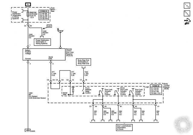

Im looking for a wiring diagram for a 2006 chevy malibu. The factory remotes arent working and I want to install an aftermarket keyless entry with trunk release.

i dont have for a 2006 but i had this for a 2005.
2006 malibu, keyless entry wiring -- posted image.

Power Unlock ORANGE (-) AT PASSENGER FUSEBOX
PowerLock BLACK/ BLUE (-) AT PASSENGER FUSEBOX
Trunk Release WHITE (+) AT DRIVER SIDE FUSEBOX

do you know the door pin wire color or domelight supervision wire?

All Door Trigger BLACK/ WHITE (-) AT PASSENGER SIDE FUSEBOX
   TO AVOID DOMELIGHT DELAY USE INDIVIDUAL DOOR TRIGGERS
Domelight Super BLACK/ WHITE (-) AT PASSENGER SIDE FUSEBOX

I  installed the keyless entry today.I  could not find any of the wire colors mentioned above for the door locks.I did find the door pin,trunk release and parking light wire in the drivers kick panel.Anybody know what color the lock/unlock wires are on the 2006 malibu or is there a module I cn use to tie into the factory system.

Directwire
Power Lock white - driver kick or BCM, gray 72 pin plug (C1), pin 66
Notes: The BCM (Body Control Module) is part of the fuse/relay box on the front passenger side of the center console.
Power Unlock same as power lock -1.5K ohms

Audiovox
Power Unlock WHITE (-) AT BCM C1 72 PIN GRAY CONNECTOR PIN 67
   PIN #66 - TAN PLUG
PowerLock WHITE (-) AT BCM C1 72 PIN GRAY CONNECTOR PIN 67 USE RELAY WITH A STRAIGHT GROUND

Sorry about the incorrect lock wires don't know what happened. As you can see Directwire and Audiovox differ on pin location but same wire color.
