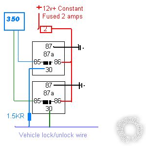

Posted: November 10, 2012 at 4:14 PM / IP Logged
Oh just do this:- pontiac_lock.bmp
2 relays and 2 1N4004 diodes.
