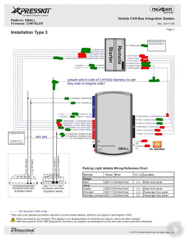

I think I'm getting closer. It took be forever to find the W2W wiring diagram. All I had was the D2D version. Makes a big difference!
I ditched the D2D connection and went W2W for all the green on my image. I didn't connect the red. What am I missing? The lock/unlock generates a response but the remote start won't engage at all (no sounds/no lights).
I'm thinking I may need to get the DBALL flashed but would like your help before spending any more money. Thanks in advance!

Posted: November 11, 2012 at 12:02 PM / IP Logged
How about the GWR Status to pin 10?

The GWR wire is connected too (mistake on my image).
The DBALL was flashed prior to purchase and worked sporadically on D2D. May need to be reflashed after switching to W2W.
One odd thing is that the ground from DBALL 10 pin is not connected for W2W but is for D2D?

As it is right now, Is there any flashing light on the DB-ALL?  Anything to indicate it is getting voltage?
Are you still using the CHTDH2 Harness?

Still using the CHTHD2. When I press lock on the fob the DBALL flashes green and Avital flashes red.
