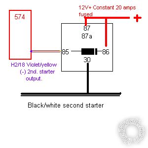

Posted: November 25, 2012 at 10:22 AM / IP Logged
OK
H3/2 RED / White That's one reason for the warning lights it won't start CONNECT.
Starter one, cut key side to H3/5,GREEN.
Starter side to H3/4 Violet.
Starter 2, use a relay and a diode (1N4004)as per the diagram:-
Diode use is MANDATORY to protect your R/S.
Wiring the two starters together as you've done is inviting trouble and expense down the road.
Why do you think some car manufacturers split those circuits?
And that's probably the second reason.
