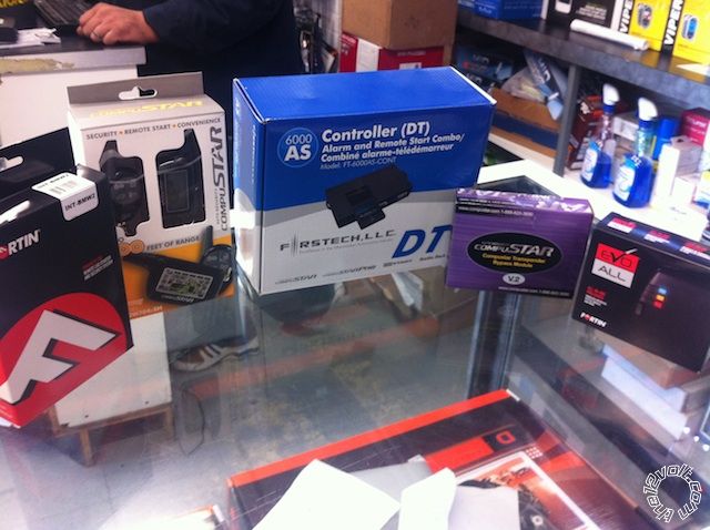

Parts Used in this Install were as Followed from Left to Right: INT-BMW2, RF-2W704( Changed to RF-P2W901), FT-6000AS, Computran, and EVO-ALL.

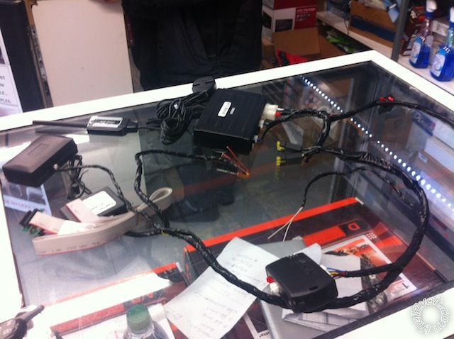

Picture above show the parts bench prepped. There are actually only a few wires to connect to the vehicle after the parts are connected to each other.

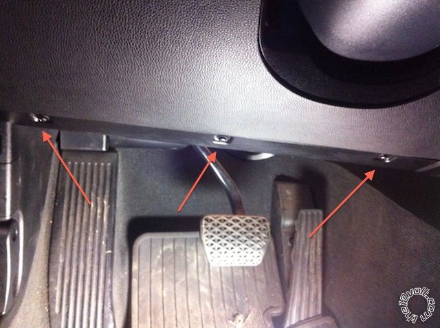

Three Screws are removed to take off the cover under the driver's dash.(Not pictured) You can access the brake harness easily to make your connections to the EVO-ALL

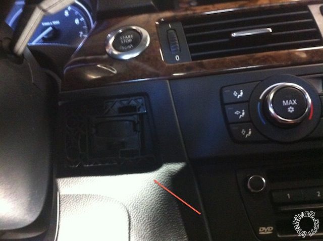

The INT-BMW2 needs to be connected behind the key slot and not at the push button. It basically is a T-Harness. Picture above shows the key slot exposed already. It has a plastic cover that needs to be gently pried. After it is pried open it will expose two screws that need to be taken out.

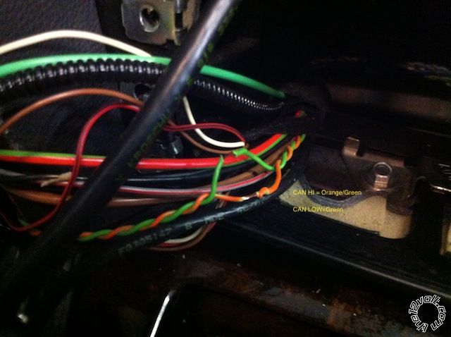

To Get to the CAN Wires I actually took the safest way but a little lengthy by taking out the radio. The wires shown in the pic are the harnesses connected behind the radio.
A benefit to this is that you can pop open the key slot by going behind the key slot through the radio opening because on the right hand side of the key slot it has a sort of a hook that doesn't let the key slot come out easily. It also allows you to route the INT-BMW2 harness from underneath through the radio opening and ultimately reaching the key slot.

- The job did take a little longer then expected but I wanted to make sure that I didn't make any mistakes. Tech support isn't' very good. I asked where the can wires were because the install manual stated that they were at the driver's kick and they said it would be behind the glove box. They might as well said that "it was in the car". Instead I looked at my mitchell diagram and found that they were directly at the radio harness.
