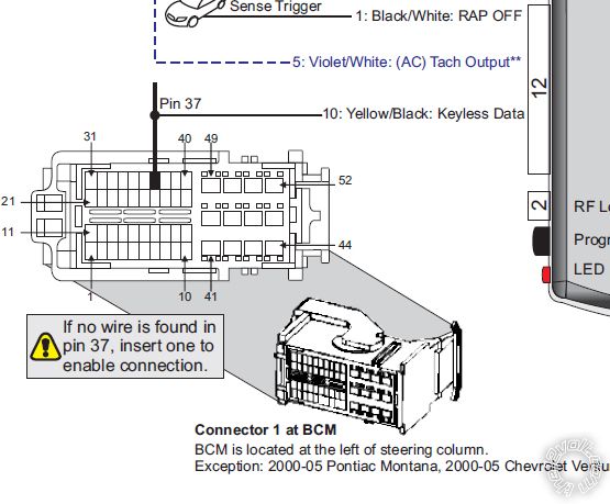

Running into one problem. The manual for the DBALL states to connect the keyless data wire to Pin 37 on the BCM. However, there is no pin 37 on the BCM and the plug looks nothing like the one shown.
Here's the diagram (I'm using Type 3 installation).
Link to the pdf guide.

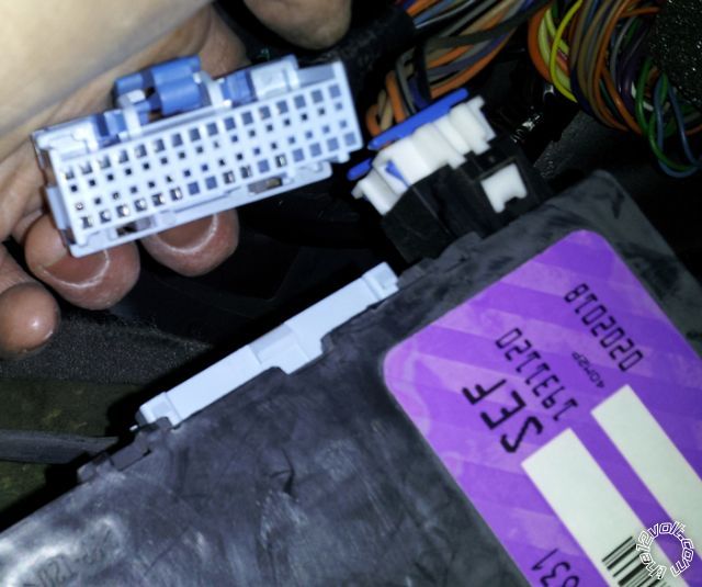

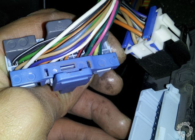

Here's the actual plug at the BCM (behind glove box to the right).
02 montana bcm pin locatiion , dball -- posted image.
You can see the plug only has 2 rows & 15 pins in each row.
There's also a smaller white plug as well, but again it looks nothing like the one in the manual.

it tells you in the diagram you posted, if no wire in pin 37 then you need to add the pin if you want those functions. i guess keyless data means that it operated the locks through data but like auto enhancers said i would hardwire the locks if you dont feel comfortable adding a pin to the BCM.
it says the lock wires are RED / black and ORANGE / black in the drivers kick panel, they are negative. and if your van didnt come with keyless entry then the wires are lt. blue and white

i just realized that you are looking at the wrong plug. the plug with pin 37 looks completely different from the one you have in your hand. that plug only has 32 pins, 16 on each row. the plug you need will have some sort of lever that you unlock and slide to pull the plug out. please pay attention to these things because you dont want to mess something up at the BCM. the picture they give youof the plug is exactly what it should look like.

Yes it's not the plug shown in the diagram. Unfortunately there are only 2 plugs on the BCM and look nothing like the DBALL diagram.

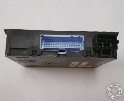

Searching for a BCM on ebay yielded this picture, so I know for sure that I was at the BCM and not something else...

you probably need to hook up the disarm wire too because ive had issues with pontiacs when not using the disarm wire. actually i think i see the lock wires in the plug you have pictured. try testing them and see what you get. it says the unlock output should be long because the BCM goes to sleep after being armed so it needs time to wakeup. ive never done one of these vans so i cant speak from experience here it shouldnt be hard to figure out with a little bit of testing.

For anyone that may need this in the future, the keyless data wire is a BLACK/ white wire in connector C2 of BCM (you can see it in the 3rd pic of the first post).
