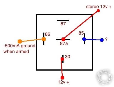

i have a 2003 cavalier, pioneer x6500bt and a viper 5704.
i want to have the stereo only get power when the car alarm is disarmed and running. reason being, when i remote start my car, the stereo turns on and attempts to pair via bluetooth to my iphone, but i am never in bluetooth range when i remote start the car so i have to manually pair my phone every time now.
the 5704 has a -500mA ground when armed wire and i am hoping to use this with a relay. heres what ive come up with:
viper 5704 on 2003 cavalier - Page 2 -- posted image.
im not sure what to energize the coil with though. im worried about the voltage spike if i use a 12v+ on the 85 pin. any help would be appreciated

soundnsecurity wrote:
use a relay to break the red wire from the radio during remote start will keep the radio off until you deactivate the remote start.
85: ground when running
86: ignition
87a & 30: split the red wire at the radio between the two pins.
didnt think about splitting the wire at the stereo, that makes a lot more sense than what i came up with. as far as 85 and 86, is there a way i can use that ground when armed wire instead? id prefer it to work off of that instead of whether the remote start is active.
