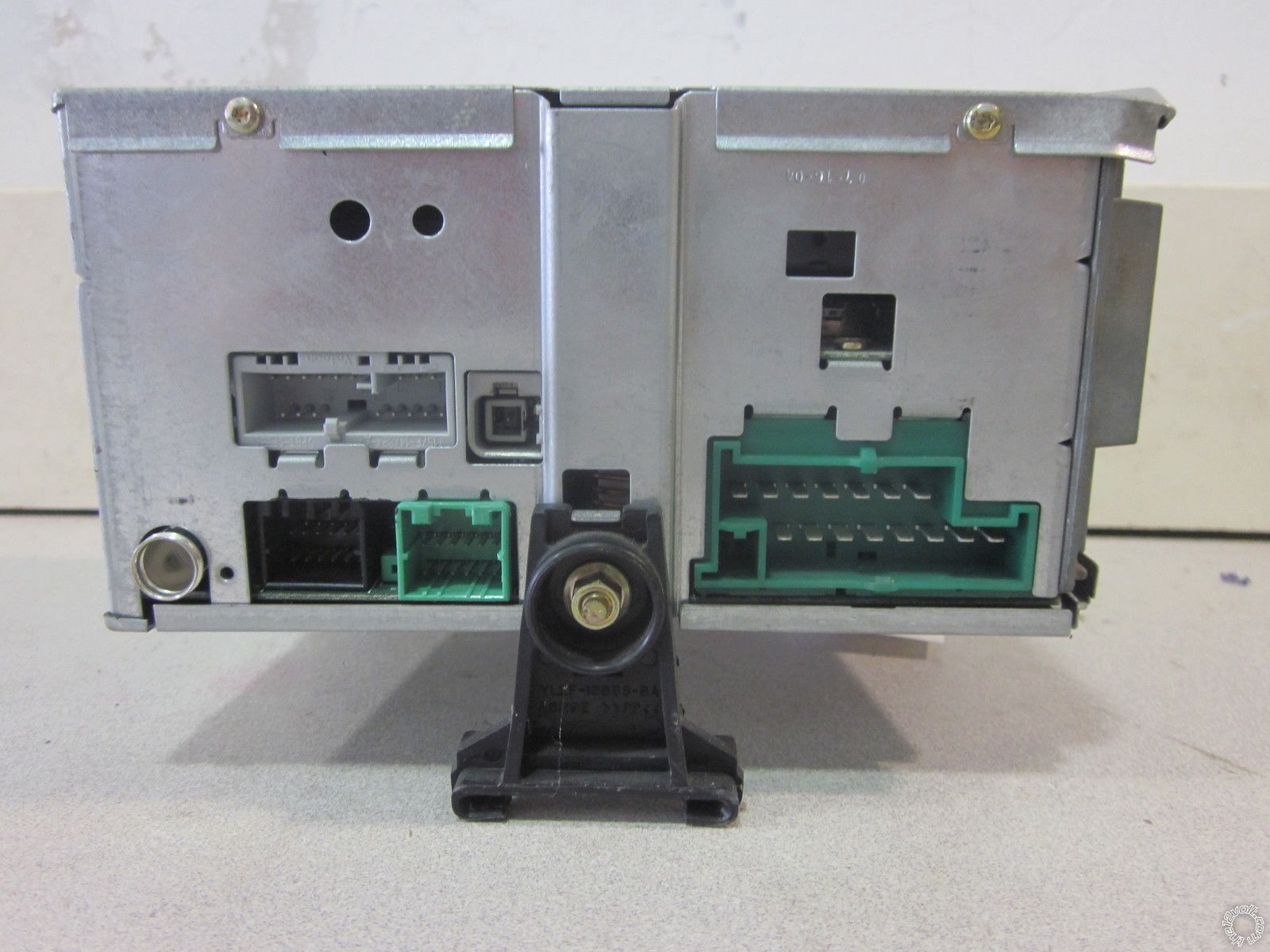

can you post some pictures of the plugs behind the radio?

Posted: December 15, 2012 at 10:13 AM / IP Logged
2006 Expedition w/Nav, New Head Unit with Factory Sub -- posted image.
Thats the back of the radio. The right hand side is power/speakers, left hand side is gps antenna, cd changer, rear seat ent, and im assuming the sub. the plugs on the left, none plug into the kit that we had talked about earlier.

Posted: December 15, 2012 at 10:17 AM / IP Logged
i meant the actual plugs. the subwoofer plug is probably the green plug.
