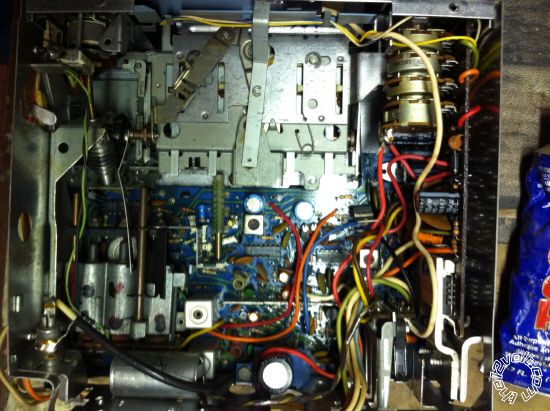

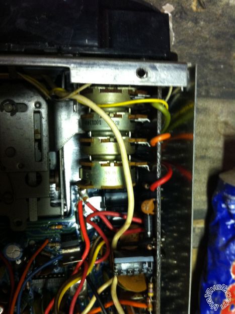

adding iphone jack to '83 delco -- posted image.adding iphone jack to '83 delco -- posted image.
Wanted to add photos of the inside of the radio so you don't have to follow the link to the Antique Radio forum.  Would appreciate any advice you have on how to add the iphone jack to this radio.

Can you figure out which 2 parts of the control are for volume?
Do you have an ohm meter?
Do you have an old pair of amplified computer speakers that you can sacrifice?

Strip the wires on the amplified computer speaker, Ground the shield to the chassis of the radio, then touch one of the center conductors to the 3 or 4 connections of each channel of the pot that you believe to be the volume controls. With the volume control turned all the way down, you will hear audio on the input section of the potentiometer. You will have to cut the foil leading to that connection and use a DPDT toggle switch to switch between radio and aux.

With the volume of the radio turned all the way down, you should find audio on one pin of each the left and right volume control. Turn the volume up a bit and there will be lower level audio on the center pin of each the left and right volume controls.
On the bottom of the circuit board that the control is soldered to, there are foil traces on that board. If there are wires that come from the board to the pin that has audio on it when the volume is turned down, then yes you can cut that wire. But you may have to cut the foil trace.
If you connect left channel to the left control and the right to the right control, then yes it will be in stereo.
