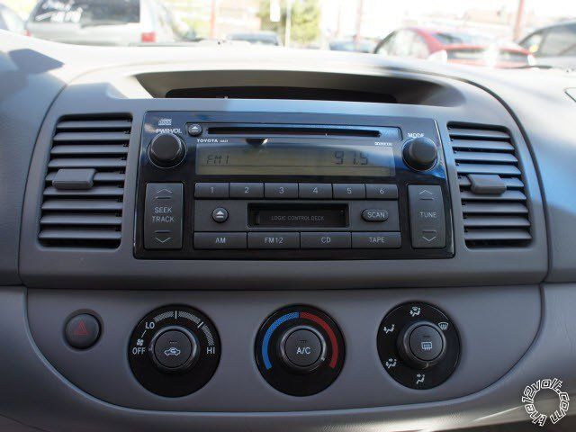

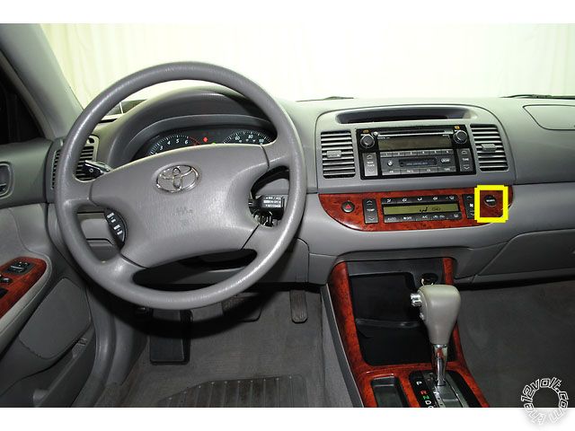

Actually not all Camry's of that year had Transponder keys, so you might not need a bypass. Only if it has a "security" light under the radio to the right does it have a transponder. See picture below, I put a yellow box around where the "security" light would be.
Picture of 2002 Camry with transponder
crimestopper rs3 g3 remote starter -- posted image.
Picture of 2002 Camry without Transponder, notice it is just blank were the security light should be
