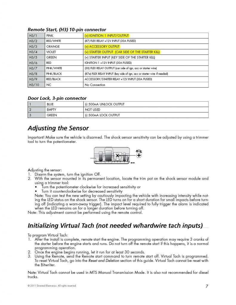

Hi all. Long time lurker here. I have installed many audio systems in my cars throughout the years, and am currently attempting my first alarm/remote start. I am installing a Viper 5704 with a DB-All interface module. I wired up the system as per the instructions that i found for the DB-All. When i plugged in the power for the alarm, there was a short inside the DB-all and i fried the unit. I am wiring the system D2D and i think the issue is that i had the 12V power and ground wires on the DB-ALL stripped as i wasnt sure if they were needed and i think the were crossed when i plugged in the D2D cable. i tested the power coming from the alarm to the DB-All and am seeing 12V on the hot conductor and the alarm brain itself seems to be working correctly. I have a couple questions before i re install another DB-all so i don't screw it up again.
1. Am i correct in my understanding that when using D2D i dont need to hook up the 12V power and ground direct to the DB-ALL as it is powered from the D2D cable?
2. Could having these 2 wires crossed cause the DB-All to burn up like that?
3.I attached screenshots below of the wires i currently have hooked up. Does it look like i need to hook up anything else when using the DB-ALL for basic keyless entry and remote start?

Q1. Yes, the DB-ALL obtains it's power thru the D2D harness.
Q2. Not sure, never tried to burn up a DB-ALL before. 2010 accord dball issue -- posted image.
First, ensure that the DB-ALL is flashed with the 2010 Honda Accord correct firmware, 401.Honda56 v1.47.
Next , make sure the Viper's Parking Light Jumper/Fuse is set to the correct polarity.  ( I usually use the (-) Gray
Parking Light wire at the headlight switch and you should too, if you are connecting the (-) Arm wire to this wire
for AutoHeadlights.)
Wire omissions :
H3/2, H3/6 and H3/9 all must connect to +12V constant power ( White @ Ignition Harness ).
Program the Viper to Flex Relay = ACC2 ( Menu 3, Item 8, Opt 2 ) and connect H3/7 to the Accord's Red ACC2 wire.
The DB-ALL supplies the Viper with a Tach signal via D2D so Program the Viper to Tach Mode ( Menu 3, Item 2, Opt 4 )
and do a Tach Learn.
The DB-ALL will supply the Viper with a Hood Pin Status signal if the car is Factory equipped with that sensor, so
the Hood Pin wire, H2/17 might not be necessary.
If H2/3 is used for the Rear Defroster, program the Viper accordingly.  If it is being used for Keysense, the Viper default
setting is OK.
