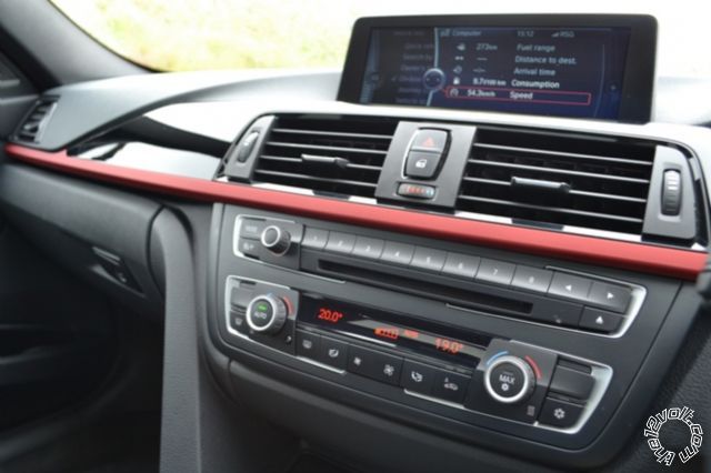

2011 bmw 320i -- posted image.

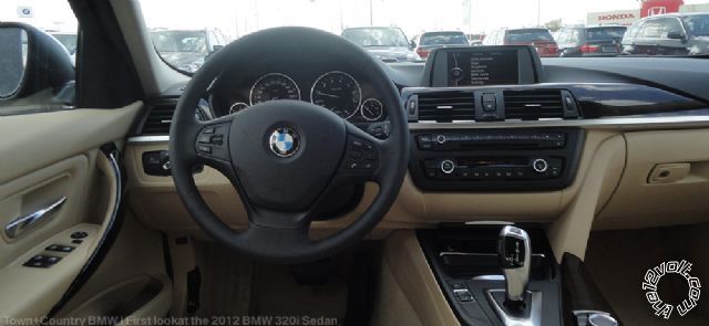

is this how the dash looks in your BMW in question?
i know BMW likes to hide the locking clamps behind the radio knobs. usually an allen or torx bit is needed to release the clamps. ive only done a few older BMWs so it might not be too helpful.
are you wanting to take the radio out or the touchscreen on top?

I've been trying to upload photos from my smartphone, but no luck, dash is different from what you posted there. Any idea if i'll need any adapters of any sort.

without seeing the dash i have no idea where to start. they dont usually make integration harnesses for new BMW's because they use fiber optic cable to send the signals from the radio to the factory amp and data from the BCM to tell the radio and other electronics how to work. its usually impossible to change out the radio without a total system rewire and you still risk setting off trouble codes because that fiber optic data loop is broken without the factory radio so needless to say finding a dash kit is the least of your worries. if you cant find any integration parts from an online search then thats probably because they dont exist.
this is just what i know from the few new BMW's i have dealt with over the years and it may not be the case with your BMW. if you can get some pictures posted then i will try to help you to the best of my abilities but all of the pictures of the 3 series for those years all look like the ones i posted. this site will only let you upload pictures that are 800Kb or less so you might have to lower the resolution in the settings on your phone or edit the pictures on your computer before you try to post them.
