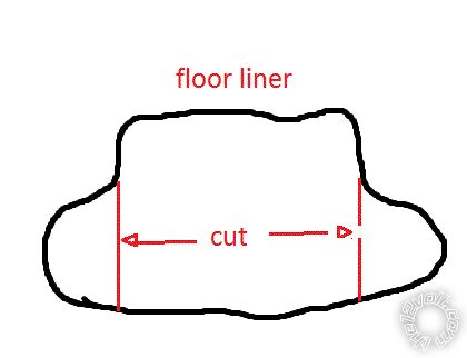

you have to make it in multiple pieces so and make them fit together like a single piece. take the trunk floor liner out and cut the exact shape out in whatever wood you plan to use. once you have that you need to find the best spots to cut it so that it will not look obvious that it is more than one piece, for example you can cut the wings off and treat them like side panels to hide the gaps in the corners. once the pieces are finished and carpeted it will be hard to notice the seam.
amp rack raised floor/recessed amps , acc -- posted image.
or you can carpet the top with a single piece of carpet and then it would be held together as one piece but the sides would fold up to let you fit it where it needs to go.
