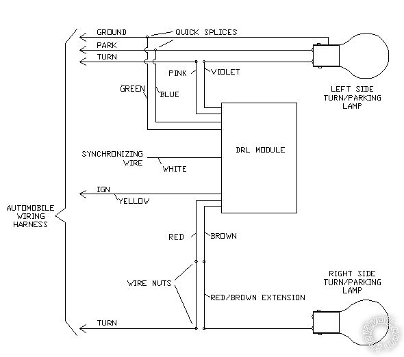

Ok my father bought one of these kits. It's not on the car yet, because we have been bench testing it. As of right now it doesn't do exactly what he wants, and wants to know if it is possible for it to do it. Right now when it's connected via the included diagram, the high filament(turn signal) comes on anytime the car is running and when the turn signal comes on it breaks voltage to the turn signal to make it flash. What my father wants to do is, during the day whenever the car is turned on he wants the low filament to come on. The reason for this, is he has Amber-White Switchback LEDs. So during the day he wants the white running lights to come as the DRL, but when he signals, he wants the Amber to come on to keep the car legal. I've included the diagram included in the kit so someone if possible can tell us how to wire it to accomplish this task. Any and all help is greatly appreciated.
webelectric drl -- posted image.

Forgot to add he also wants to keep the parking lamps white at night.

Quick splices and wire nuts? Is this thing designed for a car?
