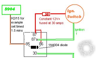

Guys, I got my viper 5904 working like a charm on my 2006 diesel pathfinder; remote start, windows, oem alarm... everything working perfectly. However, I am having one little difficulty.... the turbo timer doesn't work! I have programmed the viper to keep the vehicle on for 1 minute but still doesn't work. Please enlight me!
Thanks!!!!!
Posted: February 06, 2013 at 5:52 PM / IP Logged
Just a guess but would this be a Japanese spec. grey import to the UK or Australia?
Anyway throw away the aftermarket turbo timer and use this circuit with any spare aux output, the one I used is an example.
