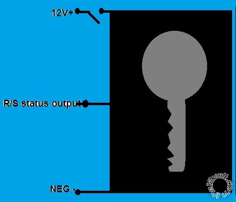

The KIB type transponder bypass module is usually connected and controlled ( turned on ) by the R/S system.
While you could set it up to be "turned on" by a toggle switch ( hopefully well hidden ) and use a plain key to start the vehicle, it would compromise vehicle theft security a tad bit.

So if i decide to try the KIB with toggle it should look like this.
kib bypass module -- posted image.

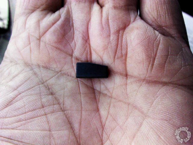

1st I'd remove the TC from the key

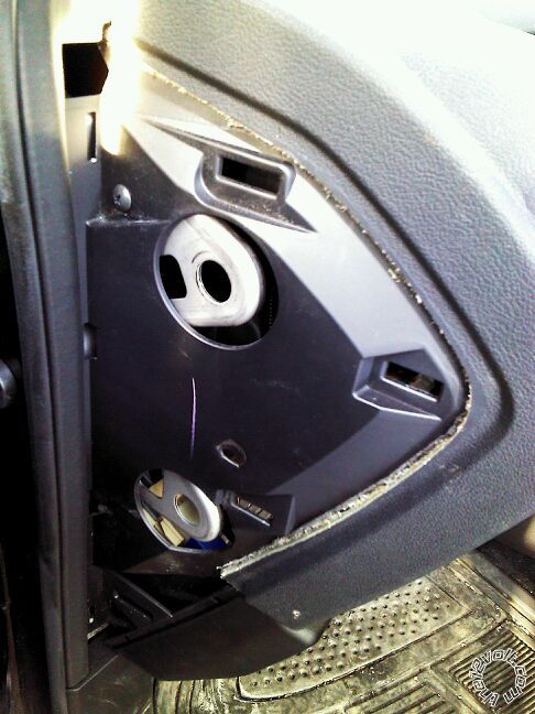

Let's beginn taking thing apart.

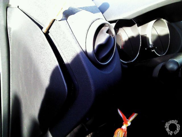

Not nessesary but I took the side apart. No screw, just pry it open.
kib bypass module -- posted image.   kib bypass module -- posted image.

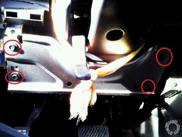

Only one hex screw holding the bottom cover/panel before pulling from the bottom up.
Next you can move the metal piece or leave it tacked so you know where best to put the RS

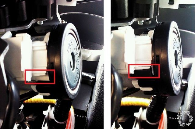

Here is the best part.  If you don't want to spend $50 on DBALL or PK09 or don't feel secure with leaving your KIB.
Use the TC removed from key and put/glue/tape it here.  Once you put everything back, it's also support by the cylinder trim.
 Fit perfectly no looping hassle, no worry about another module. As is, hard to find spot to put this RS.

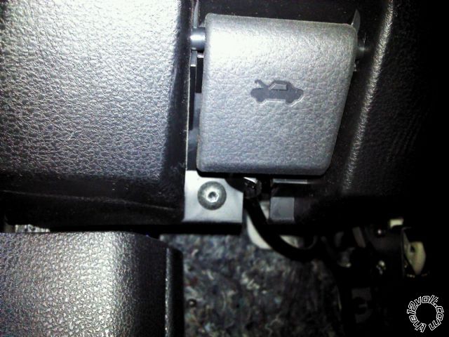

Here's the brake

I can't believe you are doing this install like this and hacking a key. With the proper bypass module you would have been done already. From the picture it looks like you popped off the tumbler??? I've never seen one that starts with just a key. They usually keep a key in their pocket and then just start the car with no key needed in the ignition cylinder. Then there is a key that slips out and starts the car manually if the battery in the keyfob dies. Now if your car is like that. YOU HAVE ALOT MORE WORK TO DO!!! The car will ONLY look for that transponder that you have permanently mounted(kib bypass module -- posted image.) if you power up the TWO keysense wires... That means another relay, 2 diodes, and obviously more wiring. You are already saving alot of money by doing this yourself, why wouldn't you want this done the right way with the proper bypass module that on Ebay sells for less then $60. You know by doing the install the way you are doing it, there will be no way to stop someone from jumping in your car and just driving away! Well you can hook up the remote starters hood pin wire to each door pin switch wire and have the car shut down every time you get in the car... Thats 4 more diodes and of course more wiring. With this particular car, doing the install the CHEAP way should not even be an option. With the bypass module you will be able to unlock the doors and drive away. If the doors aren't unlocked or you leave the doors unlocked and somebody opens the door(thief) the car would then shut down...nice and secure!
If you still want to continue in this route, I will still help you. I'll tell you all about the keysense wires(which is listed in the EVO-Can installation manual) and I will list the door pin wires so your car doesn't get stolen and your insurance not cover it because you permanently mounted that transponder chip. Don't get me wrong even with the door pin shut down wire, if someone manages to steal your car and they recover it and find that the cars immobilizer was permanently bypassed you will not be covered.
