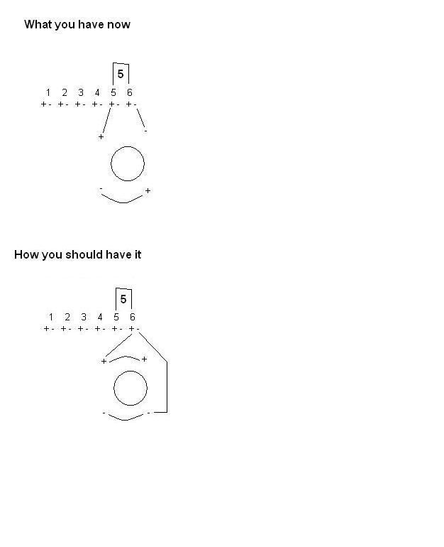

Since according to the manual your amp is 1ohm stable on channel 5 (the set of + and - farthest to the right), then here's how you will want to wire your sub (don't mind the RF in the picture!).
Beginner Install question -- posted image.

Here's a basic drawing that I made to help explain it a little better...
Hope that helped explain things a little more

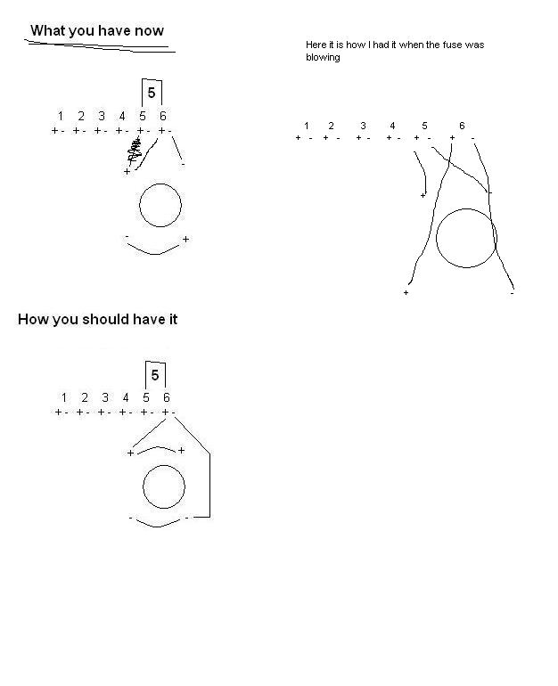

Here it is the corrected image like I had it and how I have it now.

I'll try again:
So as you can see from my drawing if the 5 and 6 are paralleled internally it should be actually the same thing with what you recommend ... or not ?

It's 2 different things. When the manual referred to paralleled internally I believe they ment "internally bridged". The parallel I drew refered to the parallel wiring of the 2 voice coils (not just the connection to the amp).
Based on what you just showed me, what I based the .5 on was incorrect. Based on what you just drew you should have had a 4ohm load, so I'm not quite sure why you were blowing fuses. It might be because you were using one DVC sub instead of two SVC subs wired like that, but I'm not certain.
The way you have it now should be safe (and I'm assuming that you aren't blowing fuses anymore). But as I said earlier you are only presenting a 4ohm load. You are sending apx 275 watts to a 500 watt sub and are underpowering it. That's why your bass doesn't sound all that good.
Wiring it in parallel like I suggested will give you a 1ohm load, and apx 500 watts will be sent to your sub. Remember, "lower ohms=less resistance=more power output(watts)". I usually don't recommend wiring to 1ohm, but your manual states that it is okay with your amp.
