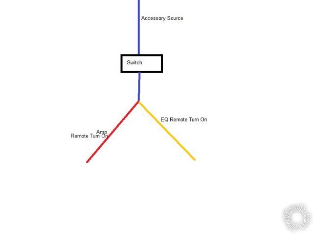

Does it require a switch? I would like to run it to a switch like This if possible. So to clarify..
Will it be safe to have my accessory source go directly into the switch and then split the power to both the amp and the EQ remote turn on inputs? As seen in the attached picture. remote power on without head unit -- posted image.

if you use an accessory wire from the car then there is no need for a switch because the wire loses power when you turn the key off. unless you just want the switch anyway.
the only reason to have a switch is if you are using a constant power source.
what make model and year is your car and i can point you to which wire to use.
