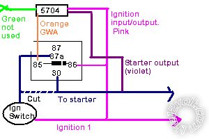

Sorry if this is a stupid question. The Viper 4704V claims to have an anti-grind relay (Menu 3, option 13). Normally the starter wire is cut, and connected to the Viper's PURPLE / Green wires.
But the 4704V lacks the green wire. It says to wire the purple (violet) wire to the starter wire:

Posted: January 25, 2013 at 2:21 AM / IP Logged
Like this! Just ignore the fact that the picture says 5704 and the green wire at left. A1E_cut_antigrind.bmp
Maybe this version is easier for you. 676_cut.bmp.
The 5704 and 4704 are identical except the 4704 is a remote start while the 5704 adds alarm features.
Posted: January 25, 2013 at 4:08 AM / IP Logged
There's a mistake on the second
Copyright Kregg 357 2013
Should be like this, don't use terminal 87.

Posted: January 25, 2013 at 9:53 AM / IP Logged
Thanks Howie -- with the 5704 it's not needed, since you cut the starter wire and attach Violet to the car side, and Green to the key side.
What's confusing about the 4704 is that it lacks the green wire, yet claims to have the onboard relay. From the 4704 manual:
13. Anti-grind Output
1. On: the high current starter relay will be activated during remote start as anti-grind protection.
2. Off: the high current starter relay will not be activated during remote start, no anti-grind protection is available.
This is why I'm scratching my head. Like the 5704, it claims to have the relay built-in. But unlike the 5704, the heavy-gauge harness has 8 wires instead of 10, and no green wire.
Am I making any sense? viper 4704v anti grind -- posted image.

it probably has something to do with the flex relay and setting it to act a certain way. if not then it may just be a typo. in any case you can wire your own anti-grind relay using the ground while running wire to activate a standard starter kill relay, just make sure you install the wires on the keyside of the starter output of the remote start or else the remote start will not crank.
Posted: January 25, 2013 at 11:04 AM / IP Logged
I think I know the answer.
5702, R/S and security, therefore it's internal relay is anti-grind AND STARTER CUT, thus green and violet.
4704, R/S only thus the violet is equivalent to the last relay diagram but all you have is the output from 30 (violet) external and no starter cut.
Green would be equivalent to 87a in that diagram.
Not misleading, no typos, just as usual for DEI, the installer has to figure it out.

Thanks for the info guys. I'll add a relay for anti-grind if the vehicle needs it. Was hoping to simply snip and solder 2 wires but the 4704 doesn't seem to support it.

I see that feature Howie, but the starter wire in the car isn't cut with the 4704. The Violet/Purple "+ Starter Output" is simply soldered to it. So how does it prevent a key from grinding the starter?
