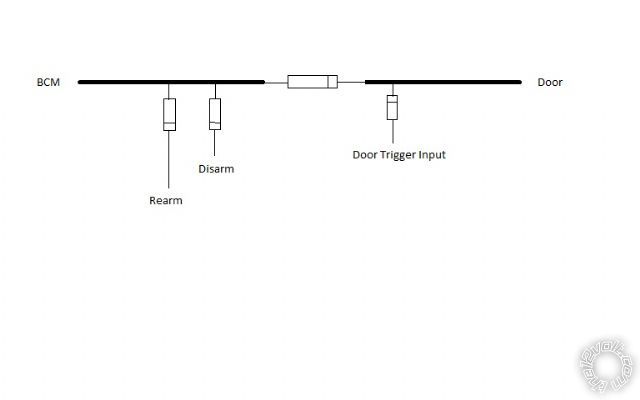

I THINK you need to cut the drivers door pin wire. Install 2 diodes with the band facing the door signal side. From the door switch itself it splits into 2 diodes bands facing the door. One goes back to the bcm side of the cut wire and the other side goes to your door trigger/arm input. Then connect the idatalink wakeup/rearm wire to the bcm side of the cut as well. Not sure if a diode is needed on that side or not, but it can't hurt. diode towards the idatalink module. I drew this on a napkin and it looks like it will give you everything you need. I can try painting it on the pc later tonight if needed.

Its a BLADE bypass into a Compustar so it is all D2D with no wiring to test the door pin. I reflashed it again and I'm going to triple check all of my connections in case maybe I missed something. If that doesn't work I'll probably end up going with diodes or a relay.

Posted: February 05, 2013 at 3:29 PM / IP Logged
I'm having a mind blank today... does this look like it will work correctly if the re-flash doesn't work?
2008 chevy hhr ss problems -- posted image.
