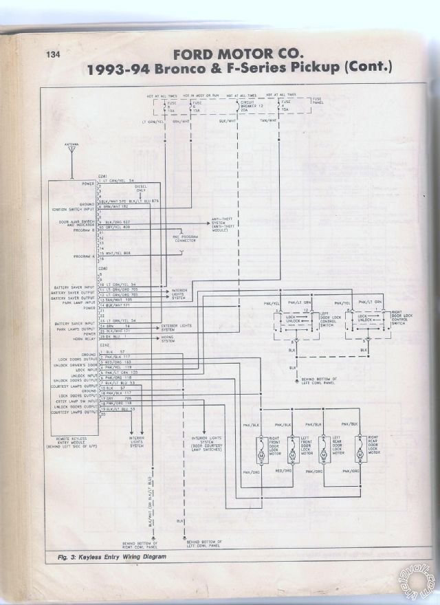

Ween
Platinum - Posts: 1,368
Joined: August 01, 2004
Posted: February 03, 2013 at 1:12 PM / IP Logged
1996 ford bronco factory keyless entry? -- posted image.
i realize it says 93-94, but compare it to your vehicle
