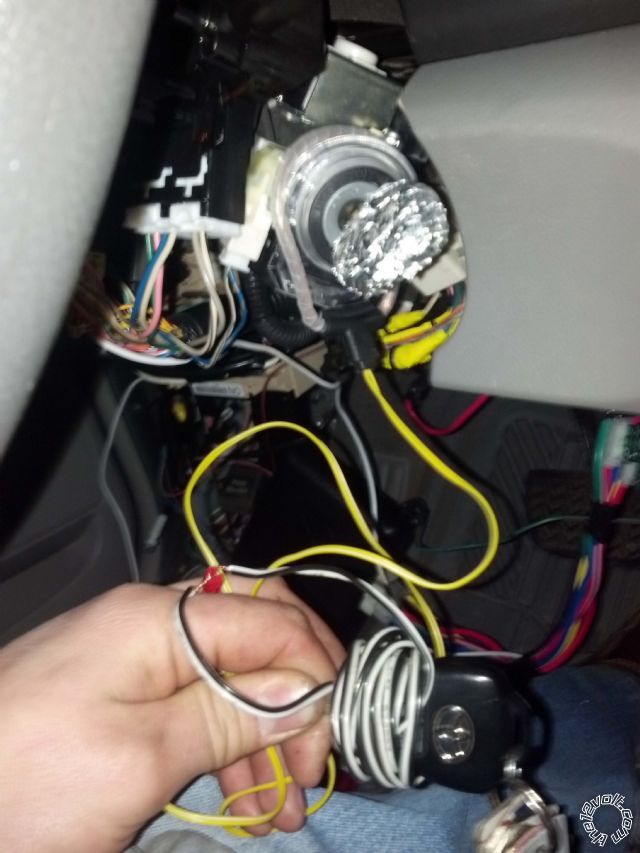

ok i did everything, programed the tach wire,
i wanted to see if i installed all the wires correctly and when i start the car with the remote, it dose not even crank,
could it be because of the transponder, i tried starting with the key in the ignition switch or like in the picture shown
2008 camry, prestige aps901c -- posted image.
Except with out the key in the ignition switch, because when i try start the car like in the picture it dose start so the simple transponder bypass dose work, any idea why it dose not crank

Use a proper transponder by-pass; Xpresskit, Fortin, Idatalink etc.

yes you need a transponder bypass and buying a real bypass is well worth not losing a key. on a side note, i cant believe that the way you wrapped that key and it actually works. if you absolutely have to keep it like that then you will have yo run those wires through a relay that only activates on remote start so you dont get conflicting signals from both keys.
Posted: February 13, 2013 at 11:06 AM / IP Logged
soundnsecurity, I was (for once) speechless, no further comments 'cause I don't want to be kicked off/demoted yet again but my thoughts about that picture rhymed with "sludge".

i found that technique on YouTube wanted to see if it work, well it did for this car.
