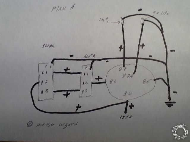

two spdt rocker spdt relay wiring diagram -- posted image. the basis for this wire diagram is hot water wizard's john deRosa response to a ? On 12Feb. 2011.
two spdt rocker spdt relay wiring diagram -- posted image. "mast lights not having power source". Poorly stated on my part. I mean to say. When mast lights are turned off at the circuit breaker panel in the main cabin. A multimeter detects no voltage at the mast base terminal block in the ceiling of the bow berth.
The mast lights are not led.
Sw #1 is 15+feet from sw#2. With relay nearby sw#2, 12v +power source and mast light terminal block can run light weight 20g signal wire for travel wire to a distant sw#1. Will use 14g +12v power source to pin 30, 87+ to light #1,87A+to light#2, 86 - to gr. ,light #1and 2 - to gr.
Relay is 40a weather proof, area of placement is enclosed dry space not exposed to elements.
Hope this is helpful. Please understand I'm way over my head on this project, i know little about electricity. My success is depend on your generosity in sharing your knowledge and experience. For which I thank you.

That diagram, means that the #2 light will be on when #1 isn't.
The only way to turn #2 off is by turning off the +12V supply, but that may be your intention.
Note that the -ve wires do not have to go to the 2-way switches - only the relay #85 & the light GNDs or -ve's.
Actually it's not a bad setup assuming that when the breaker in the cabin is on, #2 is the "default" light. But if you
toggle (flip) either light switch, #1 comes on instead.
The relay only draws its (coil) power when #1 is turned on (ie, +12V thru BOTH switches for +12V across the relay coil (+12V to #86, and #85 is 0V aka GND) which energises the relay and flips the light power (#30) from #87a to #87.
I'd suggest having the relay box accessible in case the relay contacts fail. If only the coil fails, then #2 will remain lit (assuming good #30 to #87a contacts.
Again, I hope I haven't confused you.
But reply if you have questions or concerns.
Happy boating!

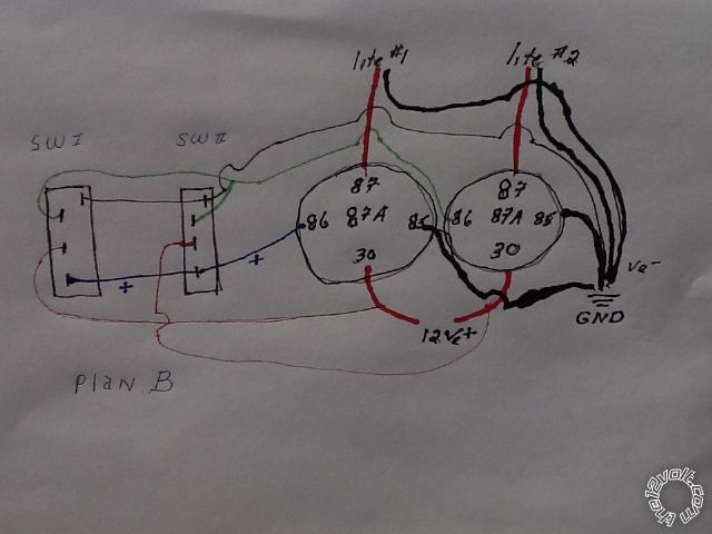

Oh my,will need to change wiring and or add another relay. But first why am I doing this project? When boat is in a marina slip frequently folks walking the dock day or night will pause and comment on the characteristics of each boat while assuming the boat is unoccupied and they are not disturbing others. I wish to turn on a deck light as signal that we are on board and are aware of their presence. It would sure be nice to turn a deck light on or off from one of the births and have to get up and go to the circuit panel in the main cabin. Sooo...
Wish to turn on or off light# 1 or light#2 from either switch. Panel circuit breaker is off.
Carling contra spdt rocker switch with led on position indicator light.
Each switch has 3 positions all latched. On. Off. On no (momentary) each switch has 4 pins
1 ve+ out. 2 ve+ in 3 ve+ out 7 ve-
Position 1 on 1-7 are closed led is on
Position 2 off. Circuit off and no led
Position. 3. On. 3-7 closed and led is on
Sorry, I should have clearly stated why I had ve- to each switch.
Sadly I have no idea how to wire the spdt relay such that we can turn on or off either light from each switch.
The relay is accessible - it is beside the bow berth bed behind access Door.
Will have 12v+ power source connected to a hidden toggle switch.
Note boat guest like to fool with boat switches ...batteries drain fast .
So how the heck does a guy wire this thing?

two spdt rocker spdt relay wiring diagram -- posted image. This arrangement will allow for controlling either light from each switch. The main cabin breaker panel remains functional
Thanks to those providing pertinent guidance, your efforts are appreciated. Cheers.
