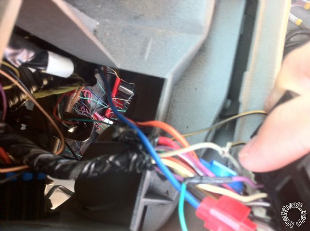

So the problem I'm running into now is that I can't program a setting through the control center. They say to open a door, turn the ignition on then off, then press and hold the control center button to activate the menus, but when I do that, the valet mode comes on??? Anyone ever ran into this problem?viper 5704 alarm/remote start -- posted image.
Posted: February 17, 2013 at 2:20 PM / IP Logged
Running around in circles here sunshine, the unit isn't seeing a ground through the door trigger, that's why it goes into valet rather than program mode.
Quote "Make sure H2/6 Actually goes to ground when you open a door".
