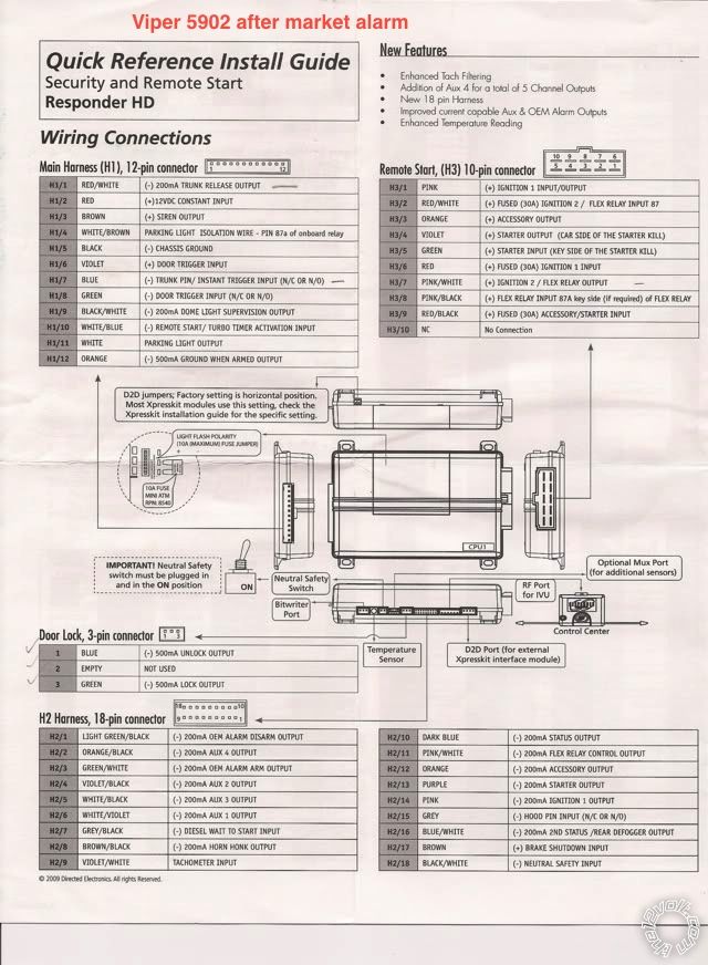

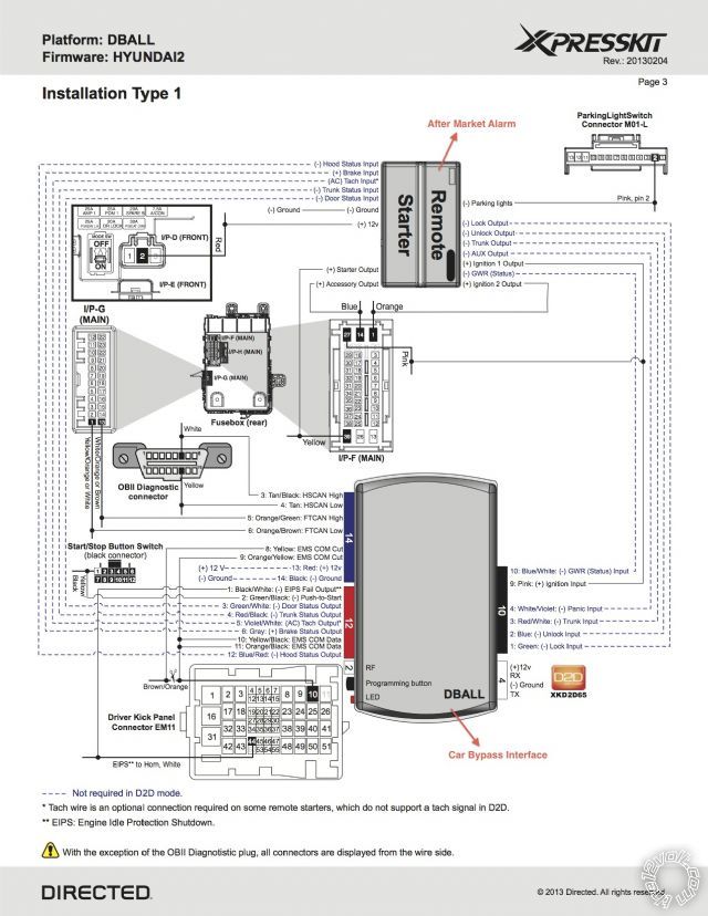

Will the DBALL when connected to Viper 5902 as in the attached image, remote start the car, Arm & Disarm OEM alarm and Open the Trunk? Viper trigger if door or hood opened without any further connection to Viper's CPU

Do i need to connect any relays or diodes in this connection?

First word of advice, don't use D2D. Take the time at the workbench and make all of the physical connections between the bypass and the remote start / alarm (W2W). Basically make all of the connections shown regardless of solid vs dotted lines. With that, the bypass should supply the door status, trunk status, and hood status (if the vehicle is equipped with a factory hood pin). Not all vehicles have a factory hood pin so you may need to add the hood pin that is included with the remote start.

Why shouldn't i use the D2D?
Is there a concern beside being able to show the hood status and so?
offroadzj
Gold - Posts: 2,043
Joined: June 03, 2005
Posted: February 22, 2013 at 9:05 PM / IP Logged
D2D is very unreliable and does not give you the ability to test anything when an issue arises. It takes only a few minutes during the bench prep to connect the wires between the unit and bypass but it could save you hours of hassle down the road.

Ok so can we revise the connections please
viper 5902 + dball in hyundai 2012 -- posted image.
      DBALL  Viper 5902
Blue Harn. Pin 13 +12V Red to same +12V on I/P-D Pin 2 in smart junction box
Blue Harn. Pin 14 - ground to chasis or connect with ground of Viper 5902 H1/5 Black
Red Harn. Pin 3 GREEN / WHITE to 5902 CPU H1/8 Green (-) Door Trigger Input
Red Harn. Pin 4 RED / Black  to 5902 CPU H1/7 Blue (-)Trunk Pin/Instant Trigger Input
Red Harn. Pin 5 Violet/White  to 5902 CPU H2/9 Violet/White Tachometer Input
Red Harn. Pin 6 Grey    to 5902 CPU H2/17 Brown (+) Brake Shutdown Input
Red Harn. Pin 12 Blue/Red  to 5902 CPU H2/15 Grey (-) Hood Pin Input
Black Harn. Pin 1 Green to 5902 CPU Door Lock Harn. Pin 3 Green (-) 500mA Lock Output
Black Harn. Pin 2 Blue to 5902 CPU Door Lock Harn. Pin 1 Blue (-) 500mA Unlock Output
Black Harn. Pin 3 RED / White to 5902 CPU H1/1 RED / White (-) 200mA Trunk Release Output
Black Harn. Pin 4 WHITE/ Violet        to 5902 CPU ?????? (I don't know to which wire)
Black Harn. Pin 10 Blue/White to 5902 CPU ?????? (I don't Know what is GWR and to which wire)
Black Harn. Pin 9 Pink Soldered to 5902 CPU H3/1 Pink (+) Ignition 1 Input/Output so
        cable will be soldered I/P-F Pin 27 in smart junction box
For this wire connection will I need any diodes or relays or fuse?
Posted: February 23, 2013 at 4:54 AM / IP Logged
Black Pin 4 WHITE/ violet to 5902 H2/6 aux1
Pin 10 Blue/white to 5902 H2/10 dark blue OR H2/16 Blue/white.
Status output, also known as GWR (ground whilst running) puts out about 200mA to ground when the R/S is engaged. Think of it as an extra NEG (-) ignition output.
