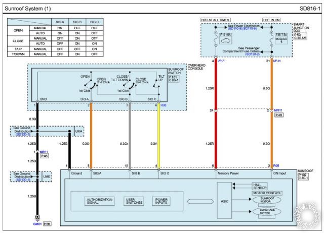

Can the 529T unit be installed on my sun roof, or there is no access to the motor wires?

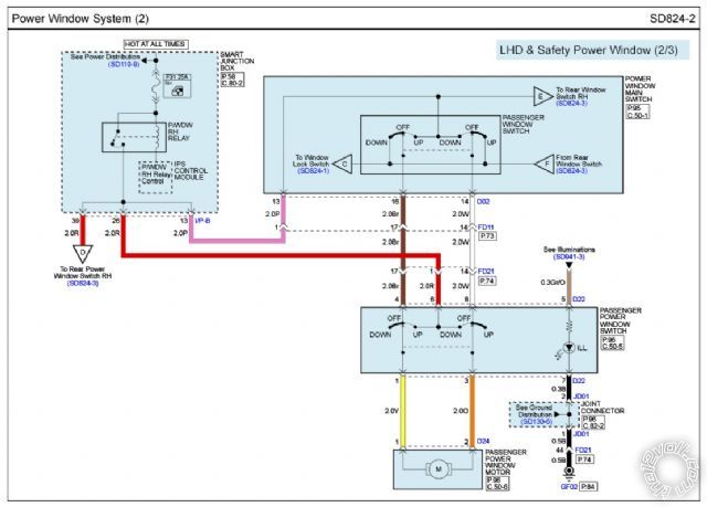

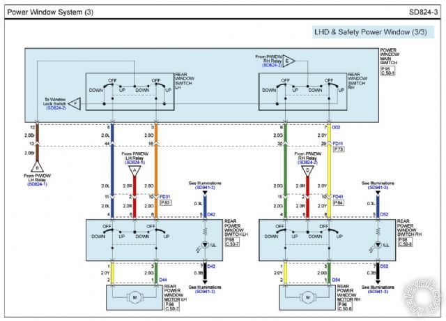

For the 530T is it possible on the driver window that has a safety module
I have the rest of the windows type A both ends of motor rest at ground right?
Sunroof Schematic
viper 5902 + dball in hyundai 2012 - Page 13 -- posted image.
Windows Schematic 1/3
Windows Schematic 2/3
Windows Schematic 3/3
