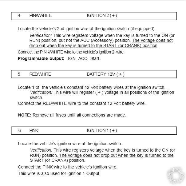

code alarm ca6552 -- posted image.
as per attached picture, I can use multiple ignition wires if available.
however, my car has one, and it matches the description of Ignition 2 perfectly.
Do I:
just attach Ignition 1 and ignore Ignition 2?
just attach Ignition 2 and ignore Ignition 1?
attach both?
If I have any other queries, I'll post up, but thus far, this is actually quite fun, I'm enjoying the challenge!
Thanks,
Gavin
Platinum - Posts: 7,828
Posted: February 27, 2013 at 7:56 AM / IP Logged
If your car has two Starter wires, then you would want to use the Pink/White programmable output for Starter2 and use the Ignition1 for the cars lone Ignition wire.  You wouldn't want to connect two R/S ignition outputs to one vehicle ignition wire, just like you shouldn't connect one R/S ignition output wire to two vehicle ignition wires.

makes sense to me!
i was just a bit unsure, as my car's ignition matches the description of ignition two perfectly, unlike ignition one. (as in, no voltage at acc.)
