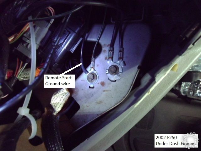

They are all for show....   soldering vs crimping -- posted image.       ( no crimp, only solder under that heat shrink tube )
