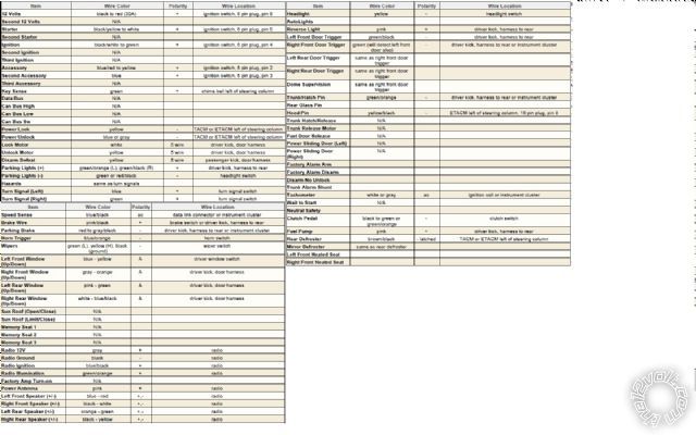

Will I be able to pick up a tach wire, even if my car doesnt have a tach?
2004 hyundai accent responded one -- posted image.
If so any Idea which wire it would be, I keep reading that it should be white or grey, but I dont see either of those wires.
Any other way I can figure it out, I know its an AC signal, but what voltage range am I looking for?

GREAT SUCCESS!!
Okay for anyone who is trying this in the future, the Tach wire is the wire in the lower left position in the picture (right below the yellow wire)
It provides about 7VAC while running, and adjusts slightly when you rev the motor. After wards I had to use the program button to learn the Tach Signal. It is now operating perfectly!
