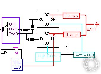

Posted: March 22, 2013 at 6:48 PM / IP Logged
KISS = Keep It Simple and Stupid.
What you are trying to achieve is over complicated and bound to fail.
Here's a simple "ultimate" headlight circuit.
One switch, latching off/on/on, one momentary switch, 3 diodes and 2 relays.
Like so, one = Lo beam, on 2 Hi and Lo plus the momentary for headlight flash.

I specified details:
my existing membrane switch panel has only positive outputs.
My membrane switch panel has two functions. On & Off.
My membrane switch panel is capable of momentary or continues.
Can you modify your circuit to fit?
built not bought
