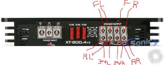

If your current speakers(and the new ones) are 4 ohms you could just hook the 3rd set of speakers up to the same 4 ch amp you have in parallel to either the front left and right or rear left and right, which would decrease the load to the amplifier to 2 ohms increasing the amount of power it puts out.
extra speakers -- posted image.

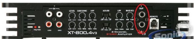

If you add another amplifier then you would have to use the RCA output from the current 4ch amp (right side black RCA OUT on image below) to go to the new amplifier.

THAT IS SIMPLE HUH?, THANK YOU FOR THE TIP AND MORESO FOR PULLING UP MY AMP AND SHOWING ME ON THAT DIAGRAM!!!

ACTUALLY I FORGOT THEY ARE 8 OHM MIDS, I WANTED TO GET A SET OF TWEETS AND A CROSSOVER SO MAYBE THAT WOULD BRING EM BACK DOWN TO 4 OHM AGAIN??
